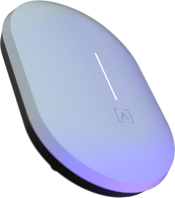

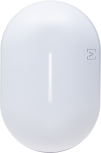

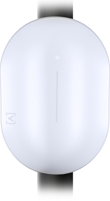

- Network Interface
- Ethernet, WiFi, Bluetooth

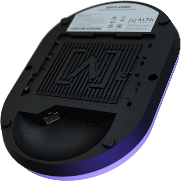

- Management Interface
- (1) 10 Gbps RJ45 Port

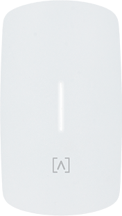

- Button(s)
- Reset/Factory Reset
- LED
- RGB

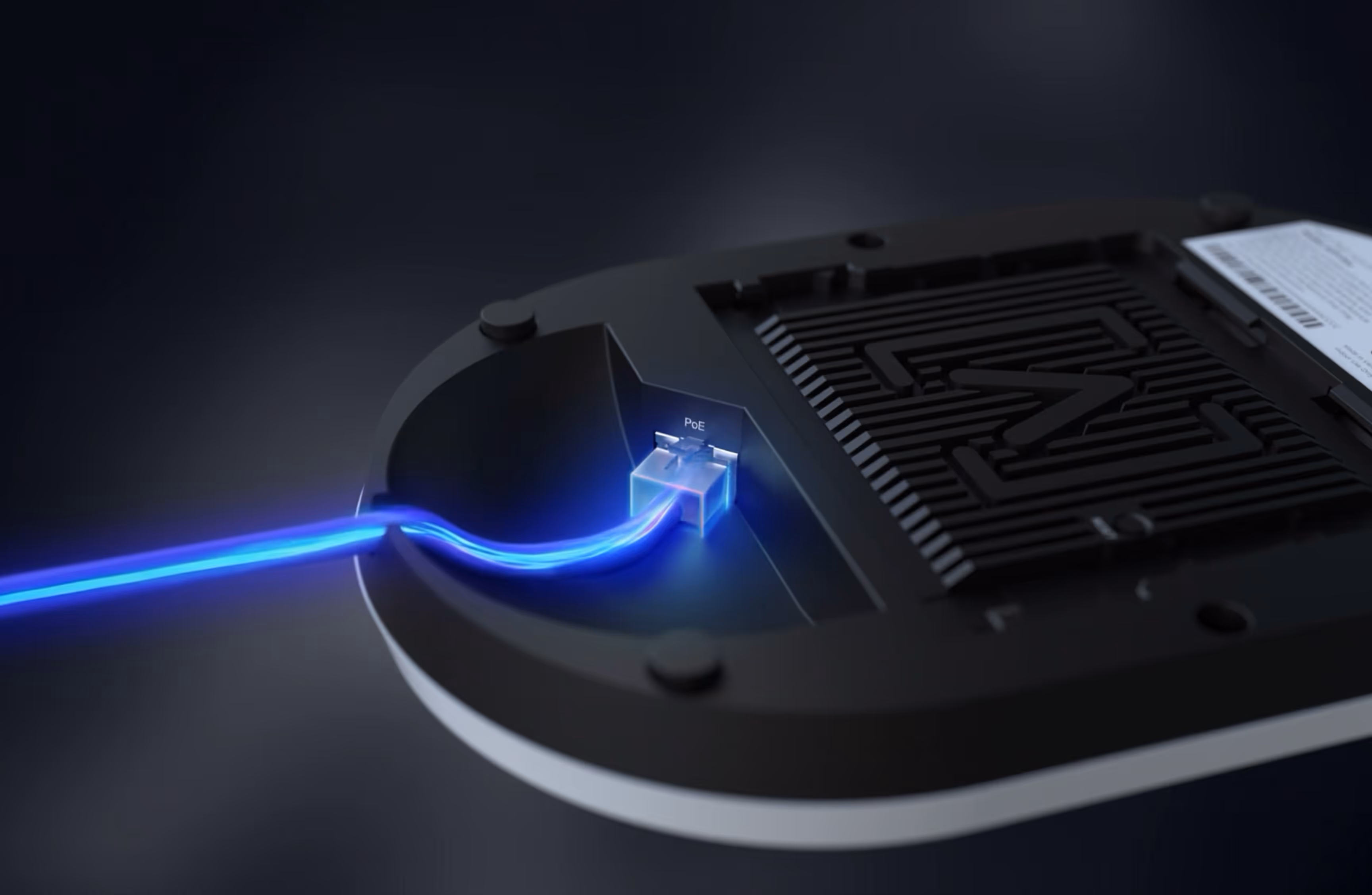

- Power Method
- PoE+ for up to 2.5 Gbps, PoE++ for up to 10 Gbps
- Power Supply
- PoE+ or PoE++ Enabled Network Switch, or 48V, 1.25A PoE Adapter (Optional)
- Supported Voltage Range
- 42.5-57V DC
- Power Consumption
- Max: 30 W for PoE+, 35 W for PoE++, 12 W Typical
- MIMO
- 6 GHz: 2x2, UL MU-MIMO, DL MU-OFDMA
5 GHz: 4x4, DL/UL MU-MIMO, DL/UL MU-OFDMA
2.4 GHz: 2x2, UL MU-MIMO, DL MU-OFDMA
Explicit TX Beam-Forming
- Throughput Rate
- 2.4 GHz: Up to 649 Mbps, 5 GHz: Up to 8.6 Gbps, 6 GHz: Up to 5.8 Gbps
- Antenna Gain
- 2.4 GHz: 4 dBi, 5 GHz: 4.75 dBi, 6 GHz: 4.5 dBi
- Mounting
- Wall, Ceiling, Drop-Ceiling, Table Top
- Operating Temperature
- -30 to 50° C (-22 to 122° F)
- Operating Humidity
- 5 to 95% Noncondensing
- Certifications
- CE, UK, FCC, IC (Visit Alta.inc for a Full List of Certifications)
